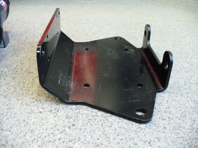

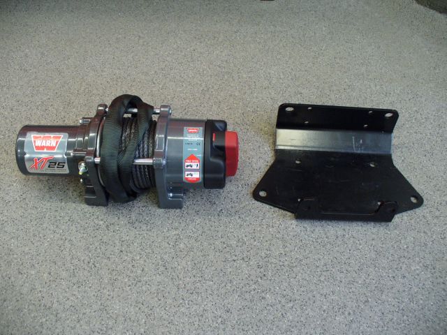

What style Warn winch are you trying to mount? - With Warn releasing the new RT25 and XT25 winches their is a new winch mounting plate to be used with them that allows better clearance. If you are using a Warn 2500ci winch you are fine using the original style winch mount. Maybe you have a new style winch with an old style mount or vice versa??

Ok! Now we have modified winch assembly plate and here are pics before and after the mod.
Now Winch can be istalled so far backward as possible. Plate and winch position on it changed total 45mm, wich means that rope roller fairlead is not the first one to make contact with rocks or other hard obstacles.
We build the Chassis armor to make the first contact...
