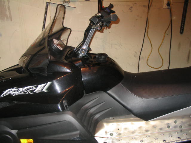

i put the 05 cable on and it is long enough. i will take a pic of my bars and post it. they are a bit too tall for my likings right now so i have a 2" shorter set of risers on the way. right now they are 35.5" from the boards to center of grip end. i spent 3 hours cutting and slodering extentions on the bar wires but now all the conections are down below the cowel and the bars are as clean as they are getting till i start to get rid of grip warmers, lights(head and tail) and thumb warmer. also want to get rid of park brake cable too!

i added the pics last night
