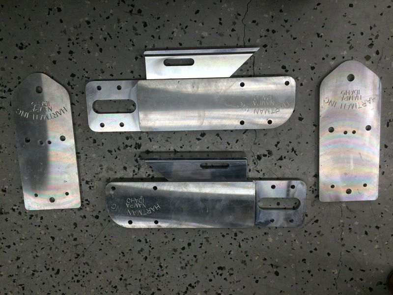

can anyone help with what model and length of track these would fit. The measure approx 8.5" from round edge to round edge.
From the length of the hyfax extender it looks like a 7" extension. So it would be a kit to extend a 121 to a 136.

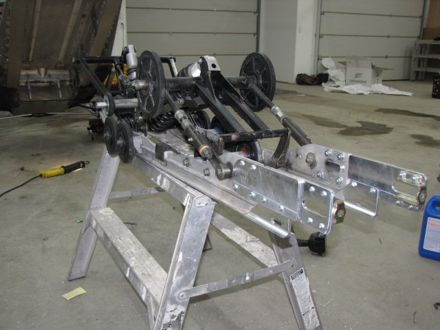

Look very similar to the Pro Action kit I used on my old Viper. My hyfax extenders were bolt on verses yours that all one piece. Had drop brackets as well.
