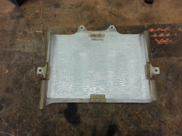

I just used the Moose racing heat shield sheets. I got them from Royal Distributing.
Here are some pics of install. I have not checked how they are holding up, all I can report is I did not catch fire last year....
Hindle with moose heat shield

My dealer ended up having some on hand......find out what it is tomorrow afternoon. Think it's the moose stuff. The McMaster stuff looks like pretty solid!
I bought the same stuff from royal and when I put a heat pun to it out of curiosity it bubbled right up in no time at all. And when I put flames to it (I know there is not suppose to have flames in there and it is a heat shield not a fire wall) it cought fire and kept burning.
It just worried me too much and I went to my dealer and bought a new heat shield. Downside is you need to buy the whole thing, metal cover and all to get the heat shield, not cheap.
Maybe it does not get as hot as I think but I was not about to risk it and bought a new one from yamaha as I was not all that impressed by the one I bought from royal and it was snowing out lol.

I've used the Moose Racing material. I also rivited strips of aluminum across the mat to secure it place.
