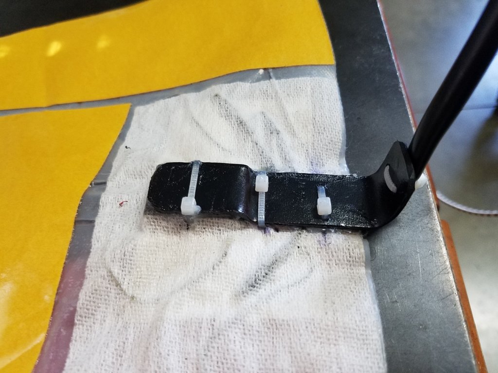

Fairly high failure rate on oem pads. Wires break from flexing right at entrance into seat foam from top side. I've fixed lots of them.
I see now there's a supersceded part number for that pad that shows "high flex" wires! Gee, wonder why they did that?
