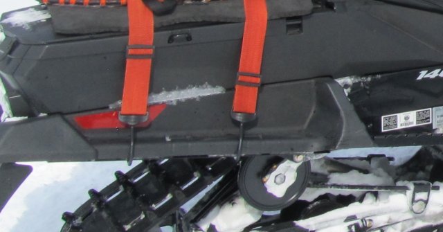

The seat comes off very easy, All you have to do is pull up on a leaver on each side to take off and it snaps on.
I love the sled for solo riding and for 2 up it the best I have ever used. U don't know the person is on the back.
The foot stop can't be take off with out taking it all of it off. Also on the inside of the tunnel pass the foot stop it not flat. So I don't thing Kimpex seat is going to work.

Allan, what do you have strapped on back? I've been trying to find a bag or rack to modify. The hard saddle bags don't do it for me.I don't think the Kimpex seat is going to work because of the foot stop at the back as you can see in picture. The side if the tunnel is not flat all way back.

Have had to use the overload spring?As an update (I thought I posted this info already). I purchased the factory seat because the Kimpex will not fit on the STX146DX. The dealer gave me a great price because he felt bad about not being able to supply the Kimpex (which he really spoke highly of). The factory seat is very, very nice. Heated butt and hands with wind guards. It is pretty heavy. Goes on without tools, just push forward (hard) and it snaps in. As for carry gear, once the plastic compartment is full I will use the same system I used on my Viking. Northface makes a water resistant duffle with shoulder straps. I use velcro ties to secure the bag to the metal eyes on the frame. I see Allan uses bungee cords in the picture he posted earlier in this thread. Glad I installed the overload springs, with an extra five gallons of gas, two up seat, passenger and gear, things are going to get heavy in a hurry.
