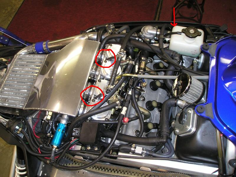

This thread has a few pics of the billet 'T's installed if you're still wondering where they go.
