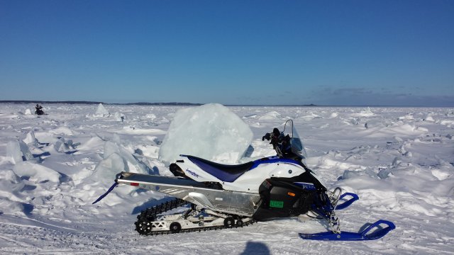

Yep, it should fit the stock brackets just fine. After 2 seasons on my Phazer with the low windshield I switched to the tall one last year. Wow, it is a whole lot warmer. The low one is not going back on

Here is a pic from last year on the ice bridge to Mackinaw, MI. While the short windshield looks better, the sled is so much more enjoyable to ride with the tall one on. G.B.
