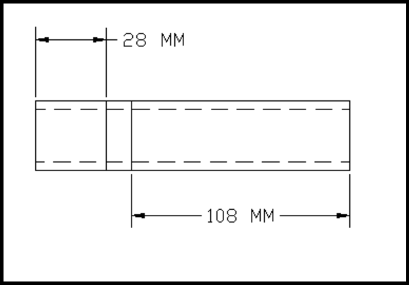

I know there are a lot of threads on this but I cannot find the info i'm looking for. I want to add a 4th wheel and cut the existing spacer but the measurements I found in the sticky's the spacer is a different lengh. Mine is a 2020 Sidewinder LTX
Mine is 165mm long. Where would i make the cuts to add the 4th wheel?

I did this to my 2019 srx, just measure the spacer on the outside of the rail and add the new bearing width too it. Then cut it and turn the piece you cut off too the same width as the outside spacer minus the washer and put that inside the rail with the washer towards the rail sideI know there are a lot of threads on this but I cannot find the info i'm looking for. I want to add a 4th wheel and cut the existing spacer but the measurements I found in the sticky's the spacer is a different lengh. Mine is a 2020 Sidewinder LTX
