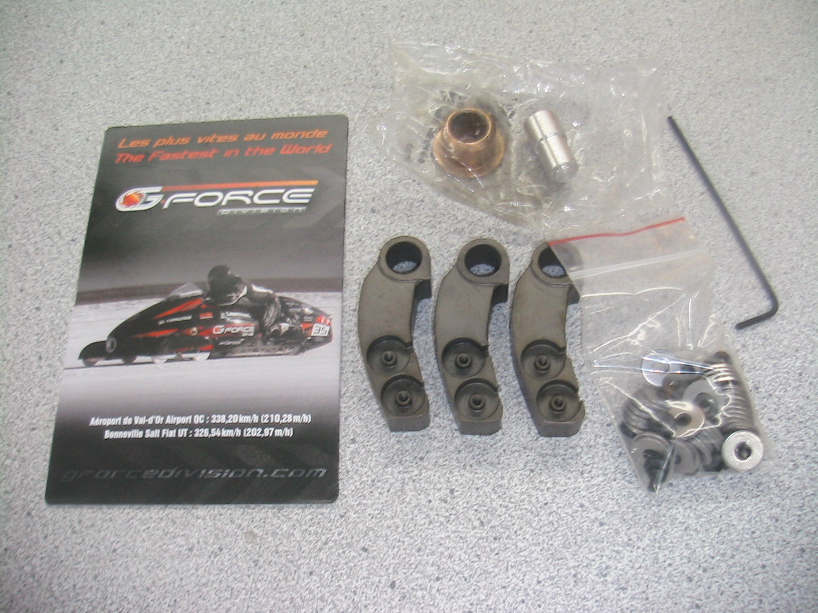

here is a pic of your weights. they look like Supreme tool weights
When you reinstall the clutch cover make sure you line up the X on the inside of the clutch cover to the X on the spider.
