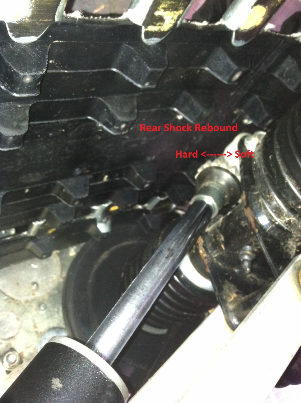

Here you go:
Yes it's going to be a slot head and it clicks as you turn it. I don't know what he took off but he should put it back.

Grizz - those pics are of a 2008 RTX, correct?
Correct, 2008 Nytro RTX 40th.
