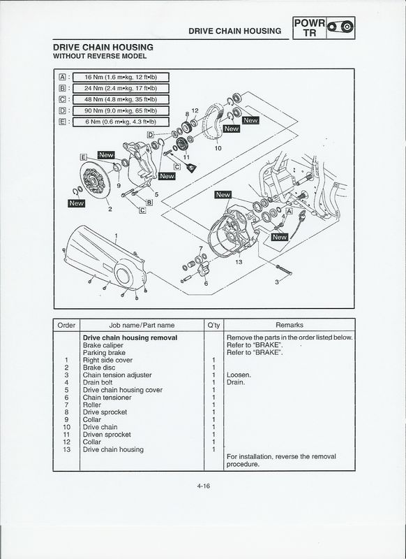

Yes, I had an isolated problem. The bearing was shot. Must have went out during my last ride causing the inner ring of the bearing to weld itself to the shaft. Luckily I was able to get it off. I took the chaincase of several times last year w/o any problems.
If you follow the steps outlined in the below thread you will be fine.
http://i22.photobucket.com/albums/b306/ ... to0002.jpg
J.
