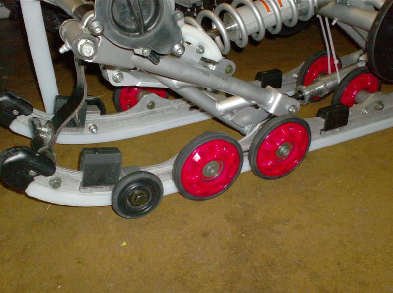

Jfet said:I was inspecting the hyfax on m wife's 2007 Rage (after replacing the cam chain tensioner) and I noticed significant wear only in front of the front idlers. It looks like it has worn down to 1/8" or slightly less. Does this need replacing already? The sled has about 300 miles estimated on these slides. This is a 136" track.
I am thinking about adding the little marginal snow wheel kit where this wear is....if they will fit...there is that rubber bumper possibly in the way. What do you guys think?
I'm not sure if the skids are the same/similar but I mounted mine just behind those bumpers, and so far so good.
Also, measure your hyfax and if it is thicker than 10mm's then you still have some wear left before they need replacing.
Like most on here say, the slides will wear fast to a certain point, then they stop.

I've got a small kit at the bend like Irv has and after 1800 miles of high speed UP trails not a problem. I also have a pair on the rear of my skid where wear was showing up. Use red loctite when tightening the bolt!!

Mine are mounted like Irv and RSVECTORFREAK and not one issue yet and I don't really expect any either.

Somebody alluded to the wear issue being commented on here. Basically that area will wear down very fast......right to the wear line......and then won't change significantly for several thousand miles. As somebody else mentioned, as long as the slider fills the gap on a 10mm wrench, you're good to go.
