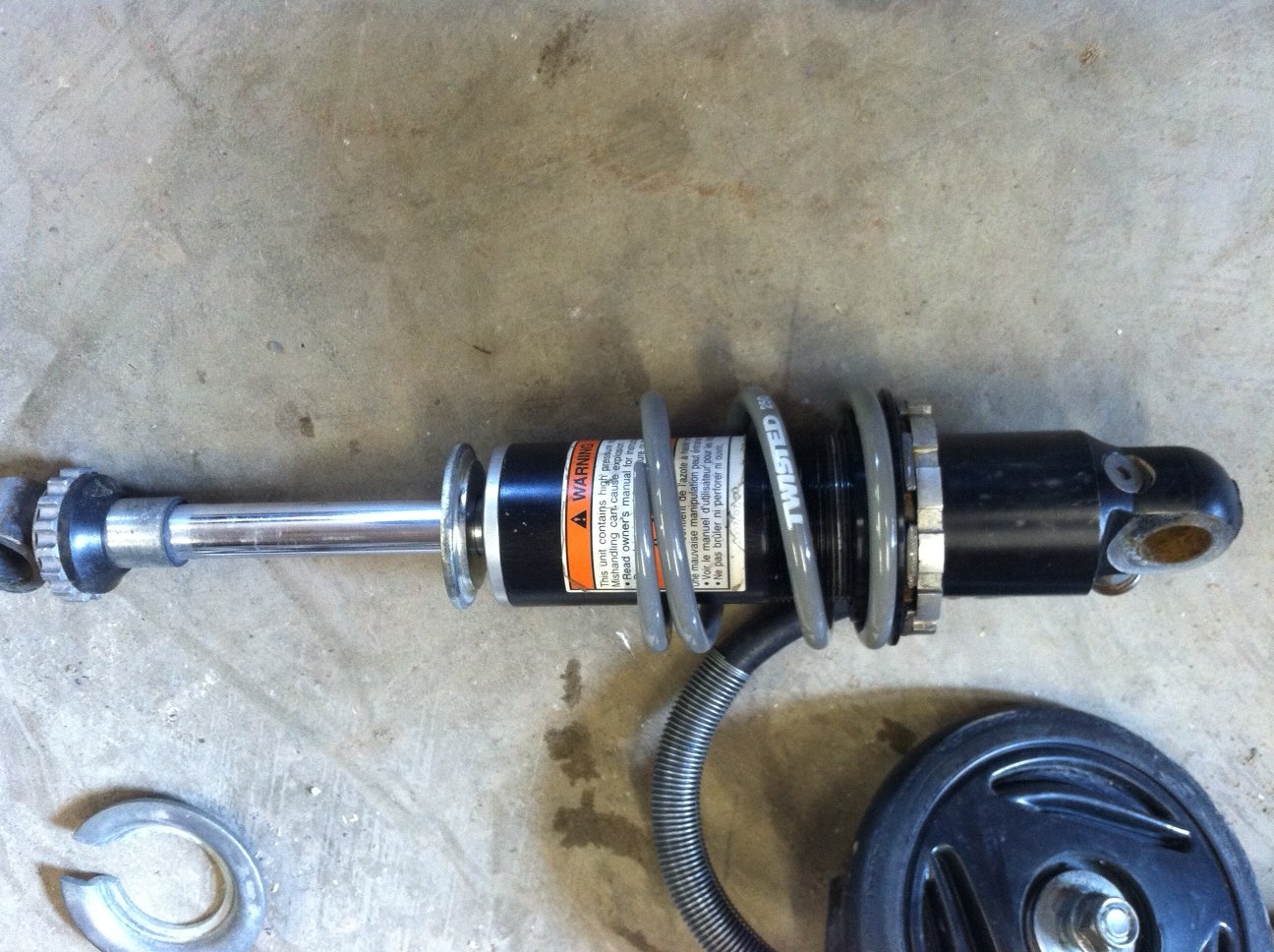

Just received a Hygear dual rate spring kit for the center shock on my 08 RTX. It appears the external reservoir hose needs to be removed to install the new spring. Is this right and if so I'm assuming the shock would need to be serviced. I guess I should have sent the shock to Hgear and had them do the install. I may have to drive up to Pioneer Performance to see if Bruce can help me out.

Figured it out. I couldn't get the crossover sleeve over the retaining washer so I thought it may install from the bottom. After talking to Hygear I discovered I was doing it right it's just a tight fit. Took a few pictures:
yox185
I knew you'd figure it out.
