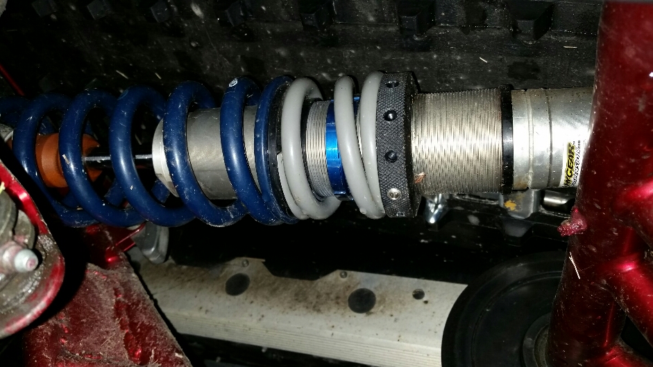

Here's what mine looked like last year....hope it helps. Works great, but still bottoms on big g outs, but no where near stock. You can feel it firm up, and then a quick bottom on the worst stuff.

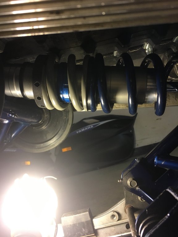

Looks exactly the same as mine we must weigh about the same cuz I have the same color springs but you have quite a bit more preloadView attachment 133985

could you measure the distance from your spring adjuster to the black coller on your shock I curious what the difference isView attachment 133986

It's all coming back...lol. We did 2 of these last year, and here's what I did:View attachment 133986
Pick the back off the ground, slide the orange bumper on the shock shaft to the shock body. Gently sit on the sled, don't jump on it. Pick it back up and measure the distance from the shock body top to the orange bumper (the shock will compress and slide the bushing up the shaft.)
I set mine at 1.500 inches. 40 mm is about 1.57 and 45mm 1.7. After pounding it on some classic tug hill trails the groomers missed, the sag went to 1.7 or so, as it broke in, so I put it back to 1.5 and left it there. Use a scale to measure...I may have used a telescope gage and miked it,but I get carried away sometimes.

Thank you! Your information is top notch, I have mine set at 40 mm , I will recheck after I put a few miles on. Thanks again! Now the front lol
