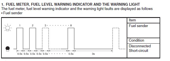

I have a code flash on 04 warrior with " dio " flash with gas light and fuel bar flash all at once , 8 short flashes the off the 8 flashes . i have removed fuel sender and looks ok and plug connector looks ok , what else should i check , I need to change the speed sensor because it broke when lower bearing went south. but i do not believe it has any thing to do with fuel guage..

To me it looks like a thermo sensor if I am reading that correctly.

Follow that link and look at the right page item labeled as number 2, it says short circuit.
grumpysanta
SORRY but thats for coolent not fuel as i said , my fuel light and fuel graph along with self dio. light all flash at the same time . 8 flashes then off and repeat .. thanks

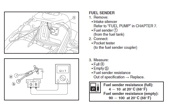

Was the sender within spec? I could be a wire issue or a ground issue. Not sure if the RX is subject to the grounding block issue but it's worth a shot....... http://www.ty4stroke.com/viewtopic.php?t=101648
There are a handful of grounding blocks in the harness, some of them like to get warm and 'melt' a little causing a high resistance/open situation. Could be the ground for your fuel sensor suffers a similar fate. You can check the resistance of the sender from the plug in the back of the dash. This will indicate any bad wiring. Test for resistance from the G/B (green with black tracer)wire at the dash, to a good ground. Anything much higher than the sender spec indicates a wiring/connector issue.
