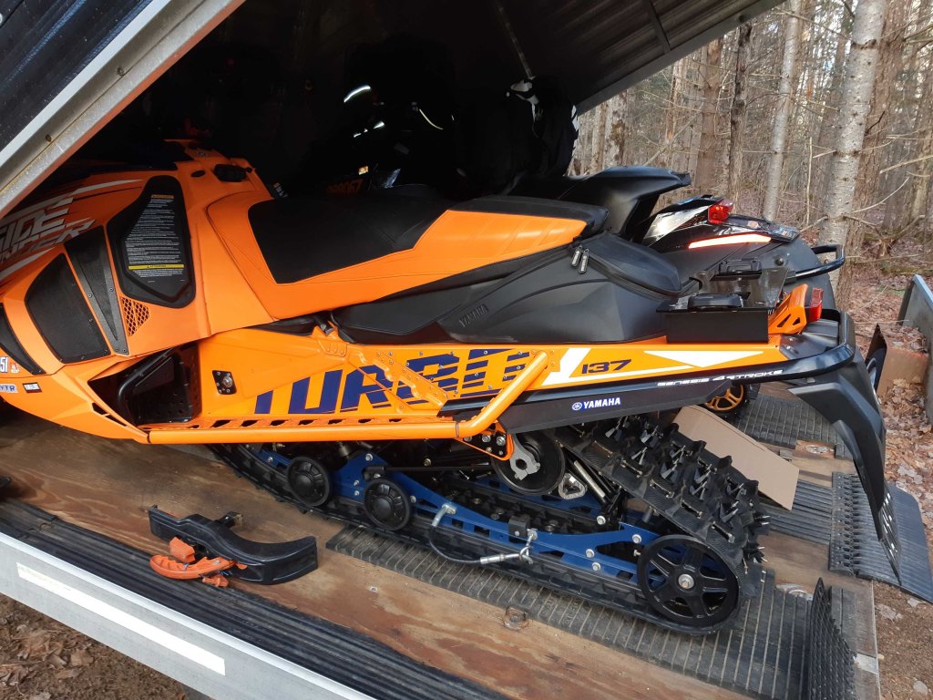

sorry just got to get to sled to take pic.s, i tried the JT wheels before i changed my track and pattern and they turned into stop signs... junk in my opinion cant use hard plastic over studs., 400.00 wasted...,, the rubber kimpex or skidoo were awesome.... not fancy but lasted, also the tricked out toy billot aluminum with rubber inserts lasted.
