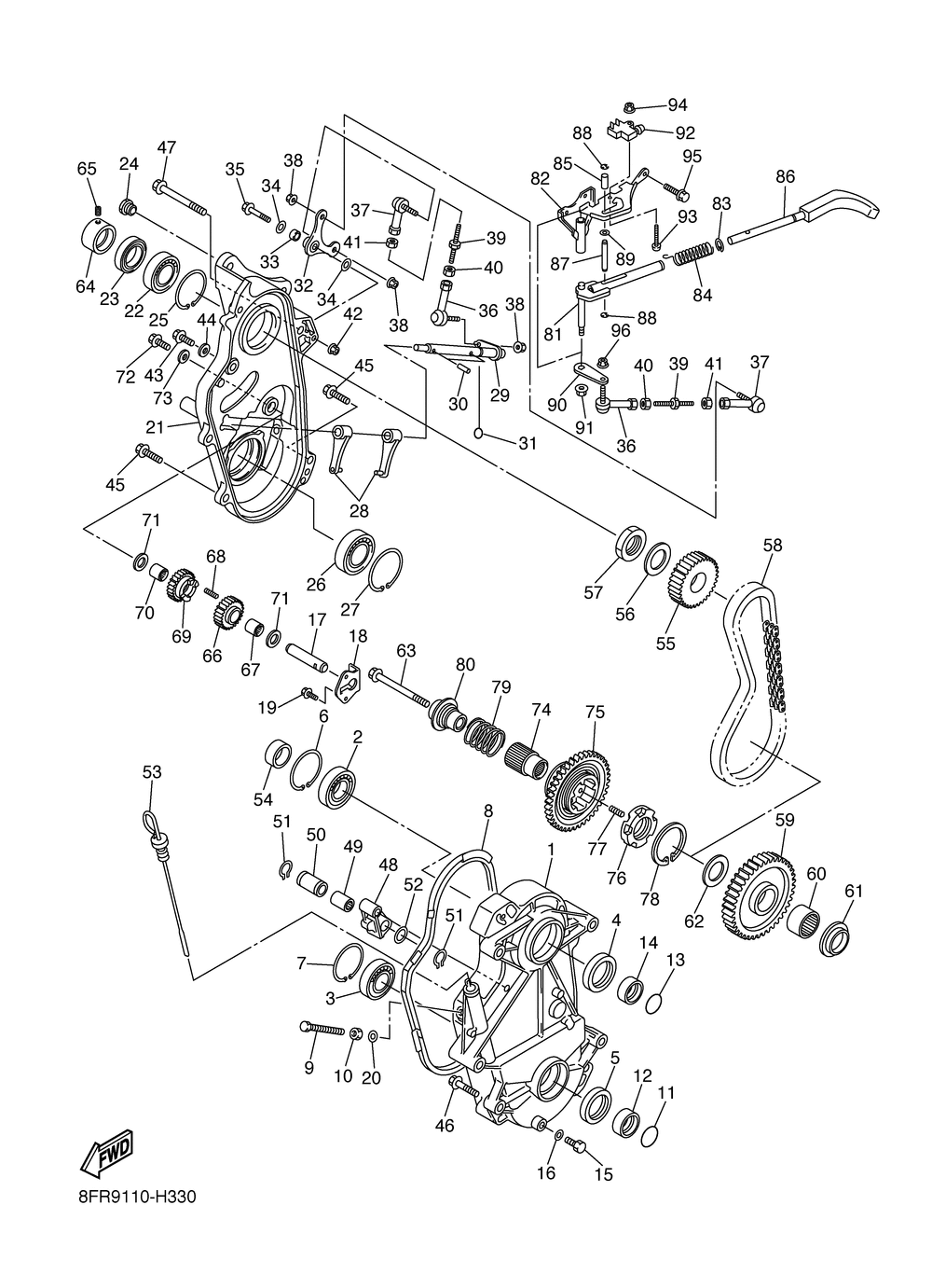

I don't see the drive shaft being any longer then previous years at least by looking at the parts diagram for 2009. Are you positive the newer drive shafts won't fit in years previous to 2009?
From what I can tell the complete gear set that bolts on the end of the drive shaft is similar to previous years, the only difference maybe item 80 which bolts on the end of the drive shaft and is inserted in the out board bearing added to the chain case cover.
