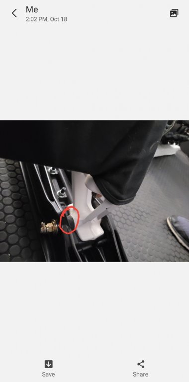

I realize this is an old thread, but I'm trying to figure out the correct way to put arctic cat skis on a 2015 Viper. Their supposedly is no left or right ski, but the way the rubber is set in it, it has to accommodate the spacer on the spindle. On the Viper (at least mine) the spacer sits on the inside of the spindle, but on cats I've looked at I have seen them both ways. Can anyone who has put cat skis on their Viper post a picture? Or know the correct way? The attached pictures are both cats.

The spacer can go on either side. It is there so you can widen or narrow the ski stance.

Ok, thanks. So, then you just move the ski rubber accordingly? The other reason I questioned it was because I already put them on (with the spacer on the inside) and they were already way wider than with the stock tuners. But maybe the cat skis are just wider to begin with. I will swap them then with spacer on outside and call it good

Marc are you sure those are 6" skis? Possible you got wider skis then the trail 6" ?? The spacer should be on the OUTSIDEOk, thanks. So, then you just move the ski rubber accordingly? The other reason I questioned it was because I already put them on (with the spacer on the inside) and they were already way wider than with the stock tuners. But maybe the cat skis are just wider to begin with. I will swap them then with spacer on outside and call it good

Just measured them. Must be 6" because it measured a tad under that in width. I guess I need to move the spacers themselves and swap sides (because the way the rubbers are on now they are accommodating the inside ) that skis are on currently.
