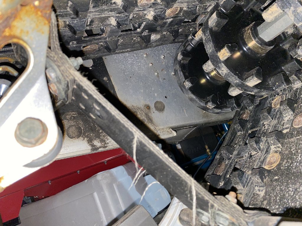

Also, while I was trying to understan0d the warning instructions that are posted on the snowtracker site and as I was looking around the attak I noticed that I am missing this part.
Which I believe is 8ED-47422-00-00 Can anyone verify this.
Given its location at the front of the slide rail, is the suggestion to not run until this is replaced or give-er and hope for the best..

Make sure your limiter strap is at factory setting ( 2nd last hole). Make sure you have the Sag adjusted to your weight. Set the Toe In of the skis to Zero. Lift the front of the sled so the skis are off the floor and then set the springs in the shocks to Zero preload.
I would not run the sled until you have replaced that plastic cap.
Thanks! Sorry, engineer - overthinking this.. When you say 2nd to the last do you mean down one (2 nd to the last from the top) or down two (second from the last from the bottom). This is how the sled was setup when I bought it. And my sled needs a bath.

One hole tighter than the longest possible setting. Definitely replace that missing rail cap before you ride it.

A missing rail cap can cause the nose of the rail to strip the clips off your track.

I know but SNOWWWWW! Staring out the window at a fresh foot. Anyhow I found someone with the part in stock, and I will go pick up a new one and a spare today. thanks for reply.
When install the new cap pump it full of silicone then slide it onto the rail. This will help keep it from rattling around and coming off.

Installed, thanks all.
