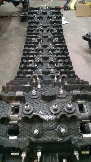

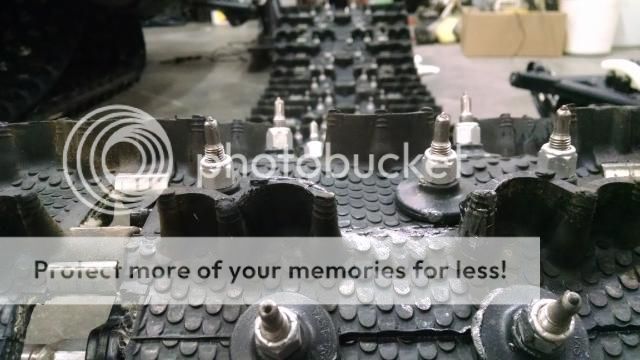

the 1 on the right is a Woody's gold digger.
