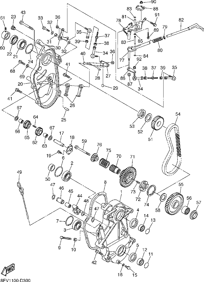

danq said:
CENA maybe this will help. The jackshaft is the shaft with the brake disk on it. The drive shaft is in the tunnel with the cogs that drive the track.
There are two "jackshaft" bearings and two "driveshaft" bearings.
There is a jackshaft and drive shaft bearing in the chaincase. These "chaincase" bearings are serviced with regular chaincase oil changes. Nothing to grease there.
The 2nd pair of bearings is on the clutch side that you access by removing the secondary clutch. (easy to do, one bolt no special tools). The upper (jack shaft) seal is easy to see after the clutch is off. the lower (drive shaft) bearing is behind a cover and the speedo pick up.
Carefully pry the seals off and clean and re grease. and you'll be good to go.
for me the hardest part of the job is getting the belt off. then I have a hard time seeing up close to pry the bearing seals off with a tiny screwdriver..

Thought a few pics might be helpful. Read these in reverse. Click on pic to enlarge and see better.
