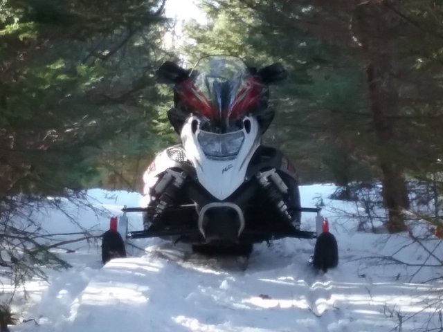

I got back from Maine Monday night , Mountain tech 43 plus 2 . And Star kit . All I can say is this set up Rocks
I can skinny ski in a circle no problem at all . If I am on a side road I can ride the snow bank no problem, before the sled would almost tip over ,so I almost never did that .this sled is a beast now . Thanks to Peter from mountain tech , and Robert from Star suspension.
.I can skinny ski in a circle no problem at all . If I am on a side road I can ride the snow bank no problem, before the sled would almost tip over ,so I almost never did that .this sled is a beast now . Thanks to Peter from mountain tech , and Robert from Star suspension.
