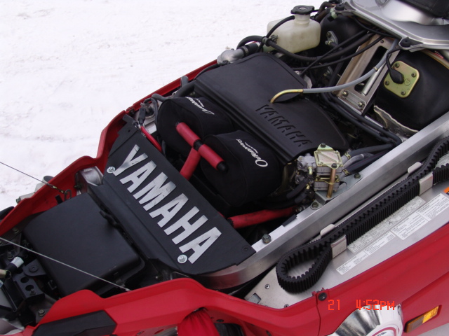

If you have an EVAC & ECP Kit, Cover the Evac lines as alot of cold air flows right over the hoses, I used my orginial snow flap cut down. I also added Foam wrap for copper pipes over them as well to help insulate them better. I can Drive it all weekend and have very little moisture come out.

Bountyhunter: Nice setup. I am only using the ECP air kit and no Evac.

Yeah, great looking set-up, Bountyhunter!
Looks like the 2 vent hoses are tee'd together, then tee'd to split to the filters. Any reason why you couldn't tee 2 vents together to the stock airbox hose? Think it would restrict the flow?
Is that a special fitting, or did you just drill a hole in the stock valve cover cap?
Do you have part numbers for the grommet and PCV valve?
Great info! Great pics! Thanks!
That pic is actually of my sled. I used a dipstick gromet from napa. Sorry i don't have the part # for that or for the pcv valve that the hose connects to. There is no tee in the line it just appears to have one as the two nreather lines are zip tied together. This set up works great. We run 5 - 10 miles at a time here to the handle bar and I've used no oil and never blown out the valve cover gasket.
