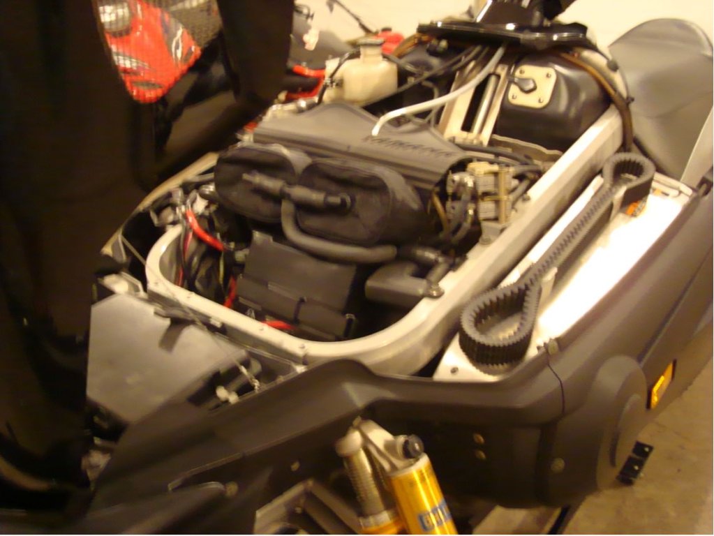

My ECP kit came a K&N filter that you were suppose to install (ie remove the stock catch can which I believe is the black plastic box you're referring to) and then guys would use a plastic PVC 'T' to run a separate hose down from the filters to catch the moisture. Problem with this setup was the potential freezing and constant draining so many reverted back to the stock plastic box to route their EVAC to. This what I had done:

That's a much more neat setup than I'm currently working with. The "black plastic box" the parts list calls a "breather" is on the right side mounted to the frame rail. 90 degree shaped.
Also the hose on mine has a a Tee for the 90 degree turn out of the top Tee. The unused end of the tee is capped off. It works but isn't pretty. That setup on yours fits night and snug.

Yes, I was calling it a catch can but as you can see in my pic, the breather is what I connected the two filters to and then from that point on, it's a stock setup (ie. the breather remains connected to the crankcase using stock tubing). If I recall correctly, I even used stock tubing for the other runs as I definitely know the hose from the T to the breather was a stock hose.The "black plastic box" the parts list calls a "breather" is on the right side mounted to the frame rail. 90 degree shaped.
Some guys like myself even went the extra mile and added what was referred to at that time as "speed rings" that you mounted to the mouths of the carbs and then mounted the K&N filters to them. Curious if yours has these:
