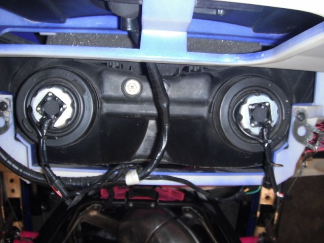

So do you pull the rubber boot over the fan or no fan on the bulb? Any pictures?
The fan unscrews from the bulb assembly if I remember right. No pics on sr viper but I may have some from old viper to show ya.

The fan unscrews from bulb assembly. Then once bulb and boot are mounted you screw fan back on to bulb.

Here are some pic's. This is on one of my older vipers, but the pattern and reach were very comparable to HID's. The last 2 pics are of HI and LOW. Hard to tell on pics but was a big difference. Rode mostly on low.

We have these ebay LED's in the Blue/White viper and they have worked great for 2 seasons now and very bright compared to OEM. I did not put the fans on because I don't see them working when they are covered in snow dust or even lasting very long getting wet and frozen all the time. It's cold out after all and the bulbs have a huge heat sink on them so I think cooling is fine. Last season we rode once with outside temps of 60F and the LEDs showed no signs of getting hot. Just my 2 cents. Let it snow!
