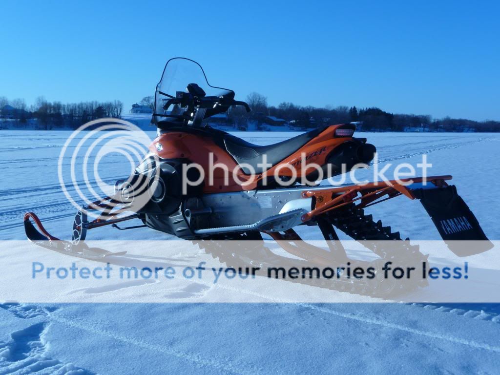

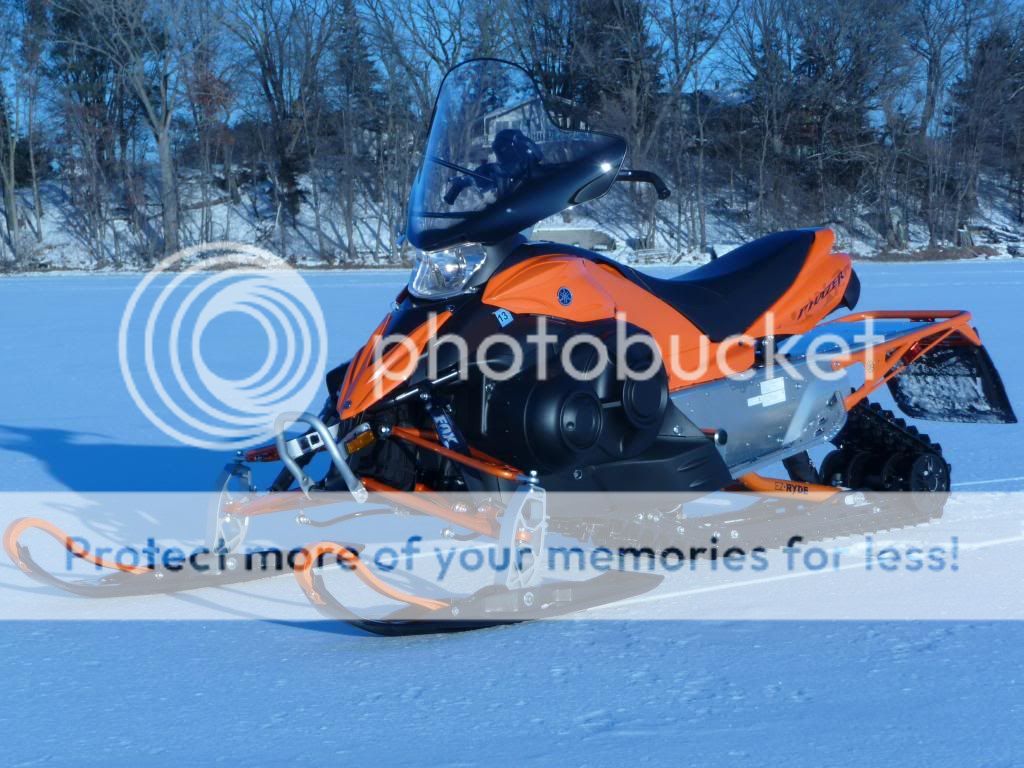

Not sure if I posted this one, but after my daughter opened up her new helmet, she had to go for a ride with the phazer and her new plastics! I and the wife custom painted the windshield and nose shroud once she picked out a sled jacket this fall.
She loves riding! And I love taking her!
