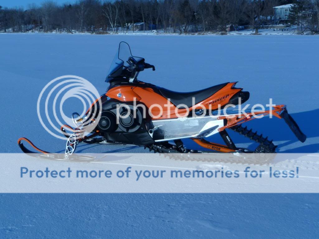

Couch is dead on about approach angle. I went to the EZ-ryde skid when I stretched my Phazer to 136 for two reasons: 1) the skid carries less snow, so I was hoping to offset some of the added weight that I would gain by stretching to 136, and 2) the rail profile of the EZ-Ryde has a less aggressive approach angle, making it a better skid for off trial riding. I've included pic showing the approach angle of my skid below.
I went with a Freeride track only because I ride trails 90% of the time, and a 1.75 lug is too big IMO when the trails are hard-packed or iced up. I prefer off trial riding, but there just aren't a lot of places where I can go off-trail in my area, so the Freeride is a good compromise. I find that the torque of this motor down low really allows the sled to crawl or "tractor" without getting stuck. The is especially true in dry conditions ... if the snow is wet, then it's a different story, as I find that I am more likely to trench as the skid and tunnel begin holding more snow. I can stop in fairly deep dry powder, and start up again with getting stuck most of the time. But I have to keep moving in wet deep snow or I'll get stuck for sure. I would think you could reduce your approach angle with some skid setback, but too much can also cause problems (like stabbing), so there is a limit to how far you can go.
If all you do is off-trail riding, the 144 x 1.75 should work well with the sled's torque and HP. The 144 will provide noticeably better flotation IMO. Coming from a 121, I think the extra length of the 144 is something that you'll get use to, and will probably like it more after you get some seat time with it.

OVR4D I see what you mean about approach angle, that ez-ryde looks fantastic in that respect. Yes I am 100% off trail. Might start looking for a 144 skid that has been taken out of another sled. Extensions are pretty cheap though too. I just thought 144 might be a bit long when hitting the ditches. I am probably 40% ditches, 60% backcountry (fields, deep snow, etc). I think 1.75" sounds good with the feedback I have got here, just not sure about 136 or 144.
