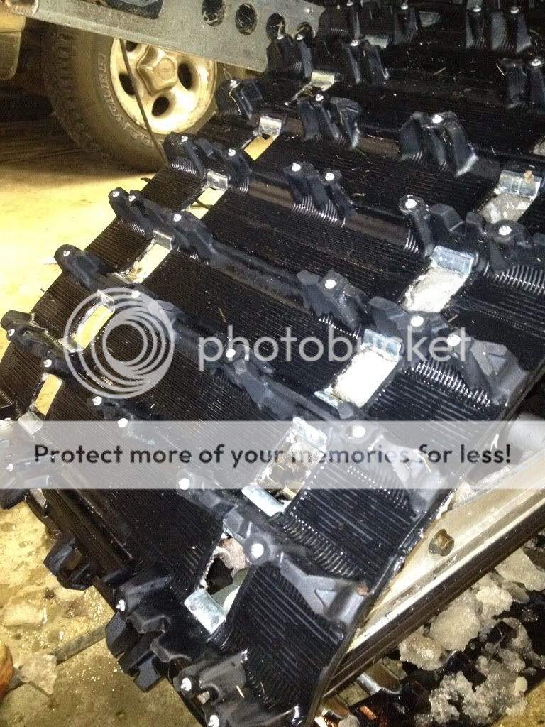

I see that your track has the frayed threads along the edge and in the track windows just like mine did. The guy I bought mine from said that it was like that when it was new and that it was normal. I didn't like the way it looked so I burned all of the frayed threads off with a lighter.
Do you have your outer rear wheels removed or does it just look that way in your picture? Welcome to TY! Please add your location to your profile.
Yea I was actually replacing my Hi-Fax when I took that pic so it looks a bit funky haha. Mine was frayed like that when I purchased it new, I havnt really thought anything of it but Ill probably burn them off like you did. Thanks for the response! I know youll enjoy yours as much as I am :yam:
