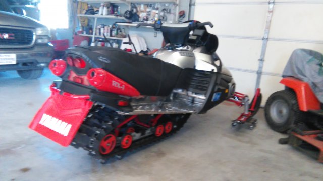

You can find some nice ones on this site that have the upgrades and they are great pull like a train.View attachment 113266 View attachment 113267
Yours looks awesome! and cool what seat would you recommend? I was also thinking of tossing a long track on, try and get a skid that has the tip up rails.
