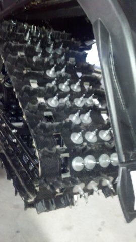

Someone brought up the concern of the metal picks in the track flying out and hitting the heat exchanger. Doesn't seem very likely to me, what do you guys think?

It doesn't seam very likely, but I suppose possible. I can't imagine there would be any more risk of that than breaking a stud off and having the track launch it through the heat exchanger.Someone brought up the concern of the metal picks in the track flying out and hitting the heat exchanger. Doesn't seem very likely to me, what do you guys think?

Not going to happen, those picks are molded into the paddles. This is what I am running on the XTX with 1.6" single ply track with 252 hp and no contact in 2000 miles. I have 150 screw in points on it also. I have had a few of those come out. When Ulmer had it on the dyno they were shooting across his shop.Someone brought up the concern of the metal picks in the track flying out and hitting the heat exchanger. Doesn't seem very likely to me, what do you guys think?
