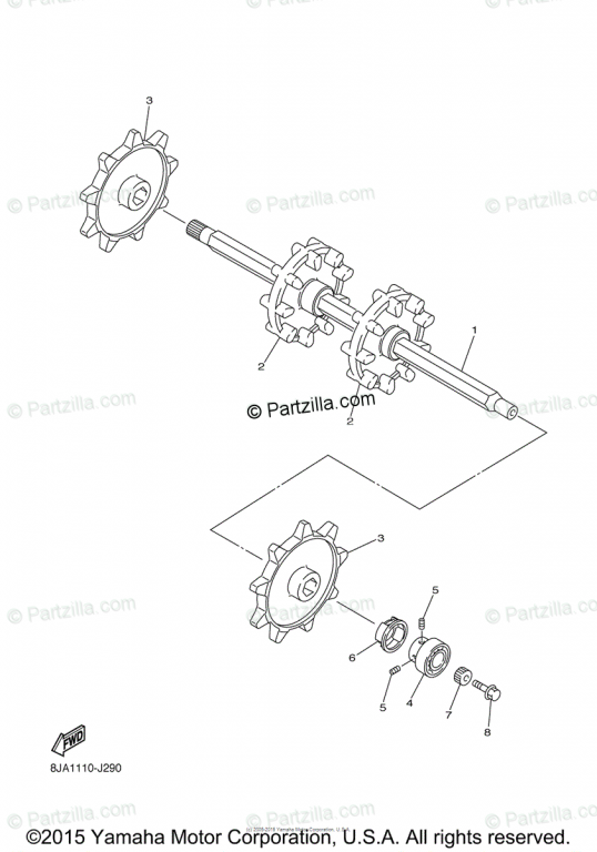

Yeah the newer ones use an added extrovert driver as shown.unfortunately with a tight track you will see rapid slide wear,you may have to get it thru the season&add the extroverts.then you can run the track loose&never worry about ratcheting againIt has 10000kms on it, so the drivers would have some wear. I bever had it ratchet on my until I changed the clutch ratio. I contemplating about changing it back, but it seems like 6-1 is the best setup. I will try tightening it a little more.

The aftermarket extroverts like Wahl makes are probably the easiest swap as you only need the 2 drivers on the shaft as they act as both an introvert and extrovert all in one.. The OEM extroverts are additional drivers to the introvert drivers so a total of four drivers need to be pressed in place. The aftermarket extroverts also result in less rotating mass.
Also drive shaft size comes into play on the 2008s as I think the shaft size is smaller on 2006-2008 Apexs then the 2009 and up shafts that had the extroverts...not positive about this though.

Great information. Thanks! I could always just change the 2 outer drivers to the OEM extroverts but I'm thinking it would be best to change them all. If I do that I am better off going with 2 wahls. I'll look into the shaft size to make sure I get the right ones.The aftermarket extroverts like Wahl makes are probably the easiest swap as you only need the 2 drivers on the shaft as they act as both an introvert and extrovert all in one.. The OEM extroverts are additional drivers to the introvert drivers so a total of four drivers need to be pressed in place. The aftermarket extroverts also result in less rotating mass.
