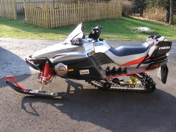

Finished the M-10 install and it really is easy after reading the install instructions 100x times measuring 10x. Still think getting the stock skid out is a lot harder than putting in the new M-10. I can't wait to try it out. I can tell just sitting on it and bouncing it that this is gonna save me a lot of hot showers and fewer visits to the pharmacy. All I need is some snow. PLEASE!!!!!!!!!
Here are some pics and one from the front with the new TY sticker on the windshield.
Thanks again everyone!! for the help and advice.

Glad to see it worked out for you.
Good luck and pray for snow!!
