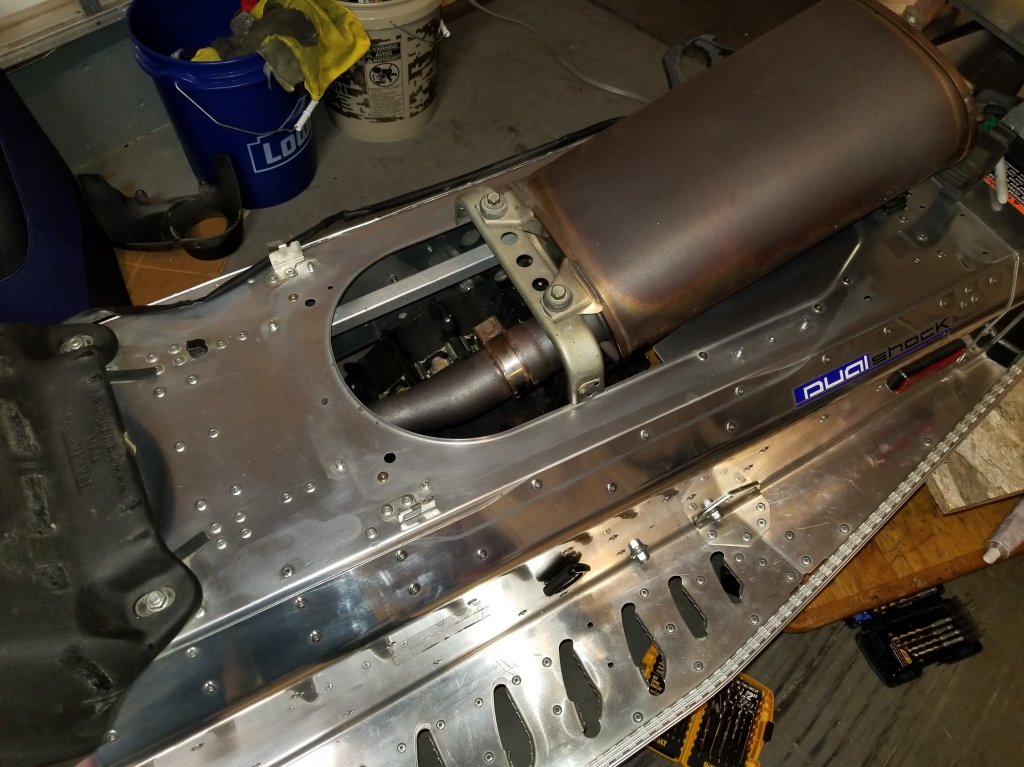

I was tired of the tunnel icing problem so I decided to make a block off plate. Just a piece of aluminum plate riveted to the tunnel protectors. I put 70 miles on the other day and had zero ice form in the tunnel, granted it was only about -5 Celsius. I'm hoping it works as well in the colder temps. Cheap and easy solution if anybody is looking for one.

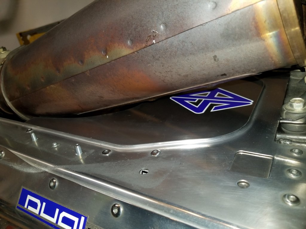

That’s a nice clean look. I just had one made for mine.

Seen it, has pretty bends

Thanks guys. I hadn't seen any other ones that were installed under the tunnel protectors like I did. Not sure why? So far it works great and was definitely the easiest way to do it.

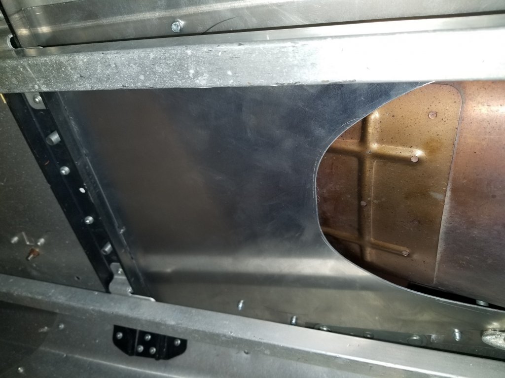

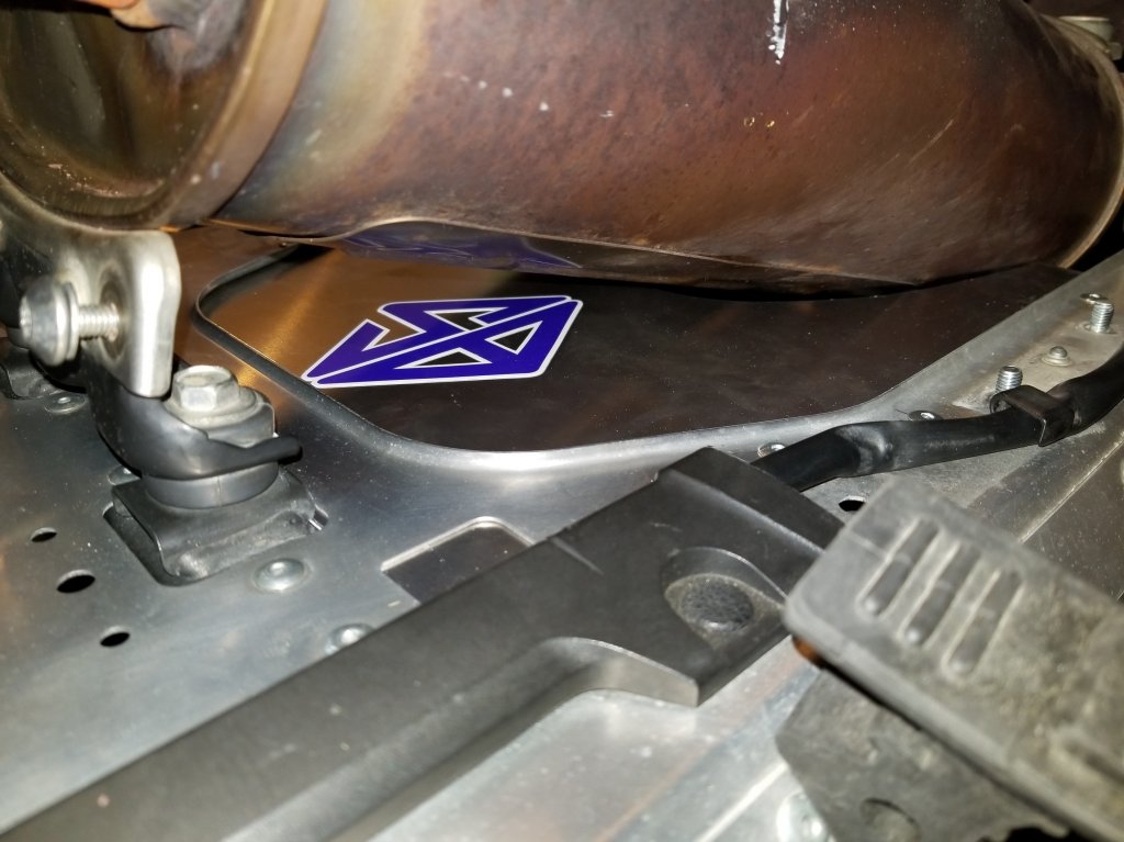

SS, nice clean look to your plate, seems like the simplest install to go on as you did. I looked around and the feedback I received on the full block off plates was that heat buildup was an issue and that the partial block off stops the build up issue where the snow is kicked up from the track yet allows the muffler to cool. On the front no build up issue so remains open for cooling. I just installed my SB partial block off, forward of the muffler bracket remains open, went on easy, will test this winter and report.

Ya I could see possible heat issues with my plate and a stock exhaust. I made that exhaust, and couldn't fit the rear plastic piece back on with it. Don't think it looks bad. The plate still exposes the headers so I get air flowing under the seat. Those half plates look like they should considerably reduce the icing as well
