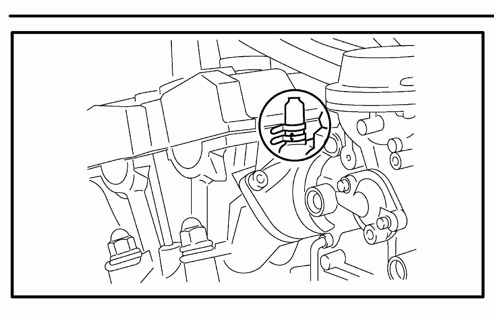

Looking at getting a manometer to setup my carbs.
I have read the psot from SUPERTUNER on doing the job, but I'm one that needs pics.
Anybody have pics on what lines to disconnect and how the tuner is connected?

It is simple Mark. You connect line 1 with the first cylinder, line 2 to number 2 cylinder and so on. I consider cylinder number 1 the farthest to the left as you sit on the sled.

Connect to the fitting's on the intake manifold in between the carb's and the head. 1 & 4 supply the vacuum to the fuel pumps. Go ahead and just disconnec these, You should have plenty of time to sync your carbs before the float bowl's run dry. If it starts to sound like it's running out of gas you can just reconect the lines on 1 & 4 for a minute or so. 2 & 3 just have plug's covering the nipples. Hope this help's

I think what he and I are interested in is exactly what lines from where on the carbs do you disconect to connect the adapters and lines so you can sync the carbs.

Or you could just add T's to the lines that run vaccuum to the fuel pumps.. That's what I did with my motion pro tool at the recommendation of my yamaha dealer. Works great.

sxmax2-- you "T" 1 & 4 so that they stay connected to the fuel pump? This way take aslong as you want to set the carbs?

sxmax2-- you "T" 1 & 4 so that they stay connected to the fuel pump? This way take aslong as you want to set the carbs?Yep, that's what I did!
