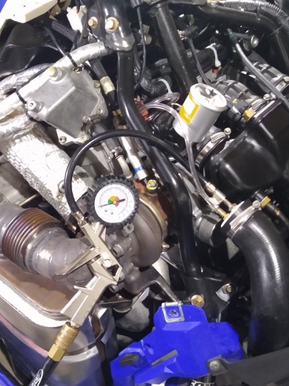

So initially I rigged up my Boost tester and cranked it up to 20 psi. boost would slide right past to 16.5 and and speed at which the boost gauge was dropping would start to slow down.
Then after tightening the three plenum clamps boost started to hold at 18.5 PSI, better than before.
I hope I'm explaining that correctly.
View attachment 171173View attachment 171174
Nice simple boost leak detector. What did you use that fit in the charge tube ?
Its an inside cap (PVC) from a hardware store. For the life of me I can't remember the size.
