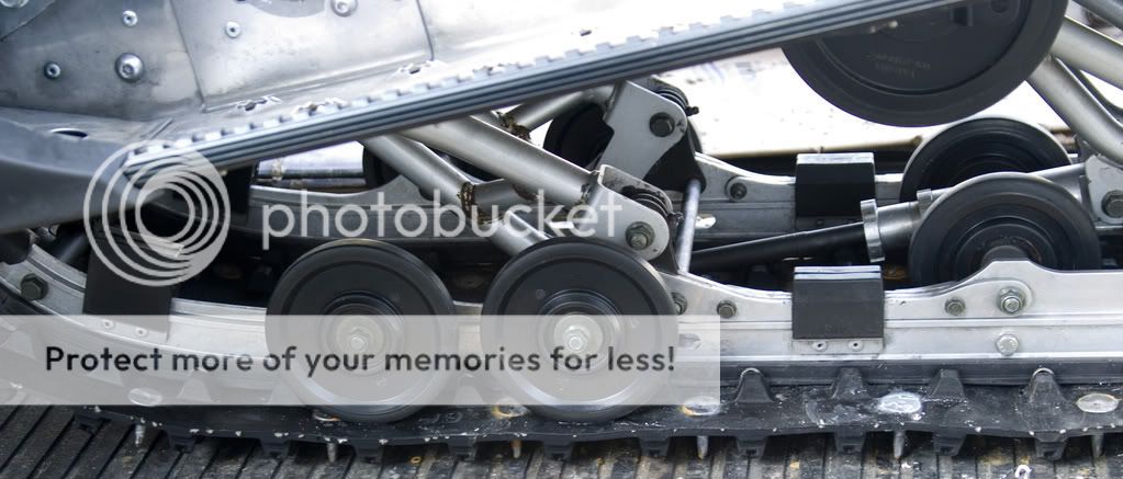

I added the Doo wheels and brackets to the original locations in the skid except for the very front and added the narrow hyfax. I also added the wheels and brackets to the area between the inner wheels and the rear to help with the Hyfax wear in that area. The first picture is from after riding about 10 miles of hard pack between 60 and 80 mph. The groomer went through the night before and then the temps got to about -5 degrees, the trails were hard pack with hardly any snow dust to lube the Hyfax. The Hyfax were new before the trip and after our ride the day before still looked new but after our 10 mile run in the poor conditions the Hyfax were half worn. The second picture is after the addition of the wheels and brackets. After about the same amount of miles in the same conditions the Hyfax still look new. I really do think I will get thousands of miles on the Hyfax now.

The rails won't crack using the 135mm Doo wheels if you use the Doo two hole wheel mounts. If you use the Doo 135mm wheels with the Yammi one hole mount it flexes the rail due having only one mounting spot. The Doo mounts have a mount below the original mount giving the bracket plenty of support.
