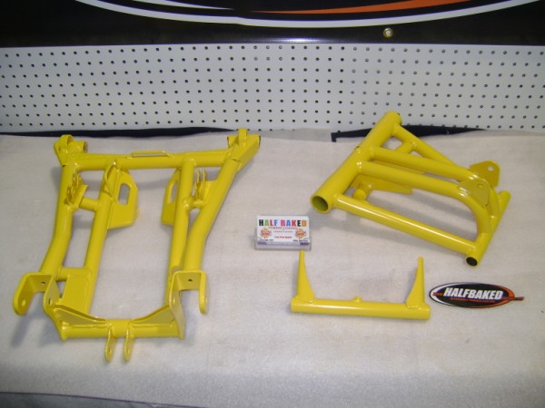

We can fix that up like or better than new for $199 + Shipping back to canada.. (we charge actual shipping to canada)
THanks and let me know
Brian
