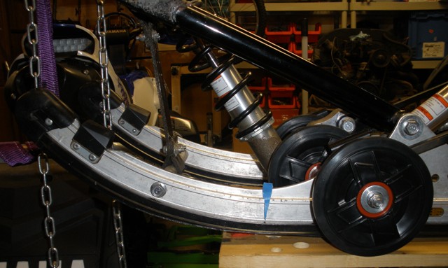

Thanks guys! The attached pics show my hyfax wear. I just put the Excel wheels on last week. It would seem that I would be locating the Low Snow wheels pretty close to the Excel wheels. Maybe I should locate the Low Snow wheels on the front edge of where the hyfax starts to thin?
This sled had 139 miles on it when I bought it last January and I finished the season with a total close to 800 miles. Does the paint wear seem normal on these skids?
Thanks, G.B.

1) yes put the wheels where you have the tape.
2) i'd be concerned. i made my own torsion spacers & they don't have that thin lip on the outside. no issues w/ 2 seasons on em. (maybe modify urs?)
3) yes the paint doesn't last on the skid.

The tape is exacly where I put mine. I used to wear out the slides in 2-2500km's and I have alomst 3000km's on these slides and I'm going to be able to use them again this season.
My small wheel is close to my excell wheel too.

Thank you xt_gt and Yamahas. I appreciate your feedback on the Low Snow wheels.
As fo the HyGear torsion spring spacers, I called HyGear this morning and they told me that the spacer shoudl not rub on the wheel. So I need to take both spacers off and measure the pilot flanges to see if they both are the same. If they are, I will have to look at both upper wheels to see if something is out of whack. Ugh.... At least the skid is still on the bench.
