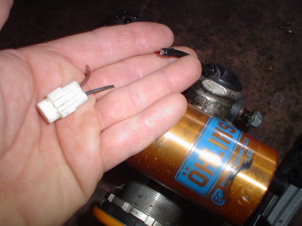

Shock wire broke (AGAIN) 3rd time
There has got to be a better way to route or design something to save the wire from breaking, it breaks in the same place every time..

Ive replaced this shock 3 times.. i have added atleast 6 zipties.. but it always breaks right by the plug in, where you can only get one ziptie.. the wiring must be able to move for the suspensiont to collapse.. the wiring is in there tight, and ice loves to build up around it..

Is the wire breaking right where it bends into the rubber sheath for the connector?
Is that wire captured under the single ziptie for that sheath, so it makes a "U"? I routed mine like the Yamaha update illustrated, I wonder how long before mine breaks...
How does the shock act after that wires breaks? How do you know?
I filled the end of my sheath with RTV to seal it from filling with snow/ice since the open end sticks up like a cup... Also should retain those wires a bit.
I don't like that sharp bend that those wires make, that can't be a "best practice" for a flex spot...

Yes, it breaks right were it bends..
The shock wont act any differently, it will just be UNadjustable..
actually im thinking of just setting it where i want it, and eliminating the wire..
