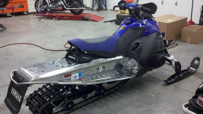

Well I finally finished modding and repairing my 09 XTX that I bought at the end of last season. When I bought the thing, I knew it needed some repairs but never thought I would end up with the list I have.
Here is a list of the repairs and mods I have done:
New subframe with grizztraks gussets
Grizztraks steering relocator
RSI 4" riser, grips, Bars and there heaters
Rox hand Gaurds
Roll Over valve w/tether
Oilite bushings
Beefed up spindles w/new ski bushings
C&A ADX skis
Evol X shocks
Pioneer Revalve on the rear shocks
Excel Wheel Kit
OFT Block off plate
Custom undertunnel exhaust using a vector header and stock Harley Davidson muffler (sounds like stock)
Copper Exhaust Donuts
Trail Tank
4th wheel kit
Schmidt Bros Stage 2 clutch kit and wet left foot fix
Custom seat support and skinz bag
Moflo vent kit
Semi polished tunnel
14" led tail light
114 Studs.
Thats the list so far, and I havent even rode the thing on snow yet. We are heading to Maine at the end of this week. I hope the thing holds together and is everything I am hoping it will be. I was hoping to get a trip in before heading out for a week but this winter isnt helping to much with that. Here are a couple of pics of it. I also want to say a big thanks to all of the good people on this site who share there knowledge on these sleds and help out guys like me so we hopefully dont have to be the broken down sled in the group. I wanna leave that for the Ski Doo guys :tg:

Nice looking sled! Where did you pick up the Skinz bag?
Ordered it from parts unlimited, It is for a polaris with the bar support under the seat.
