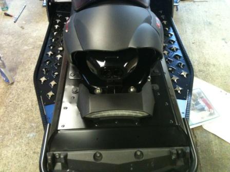

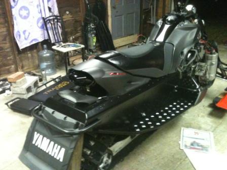

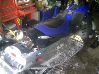

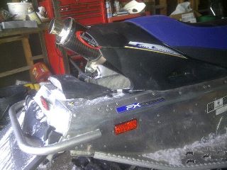

Figured i would show you all my jardine rt1 carbon fiber slip on for it. Just got it finished up today.
The pipe sounds amazing with the "race baffle", i would say to loud for you trail riders. But if you like it, and would want one i orderd for a 04ish crb 600/100RR i stress the rr part. It was very easy install. With the cbr midpipe i made one cut and just flared the end and that is how it exited the sled!
I had to make a "mini bracket" to mount the can to the original muffer rear mount. VERY easy. Obviously the original muffler plastic end peice was not put on, and had to make a easy cut in the top plastic peice. The carbon fiber does not get hot, i would say not even warm and i tried to make it hot!
Personally i did not any fuel mapping (yet it is very mild here -5ish). i have a stock airbox.
The original muffler was 15lbs and the new one with slip on is 4...so yea....
hope this helps someone!

The Yosh looks great, how does that sound? The Jardine apparently sounds great. Anyway to lower the pitch so it doesn't shoot so high up in the back?
trouble follows
Yea it would be easy, just to busy to do it right now. Have to cut a "V" in the right place on the midpipe, bend it togeather and buzz her back up. Tig would do the best job for much a thin base material which is the midpipe.
Btw jardine sounds amazing
I like how clean that yoshi is to!
