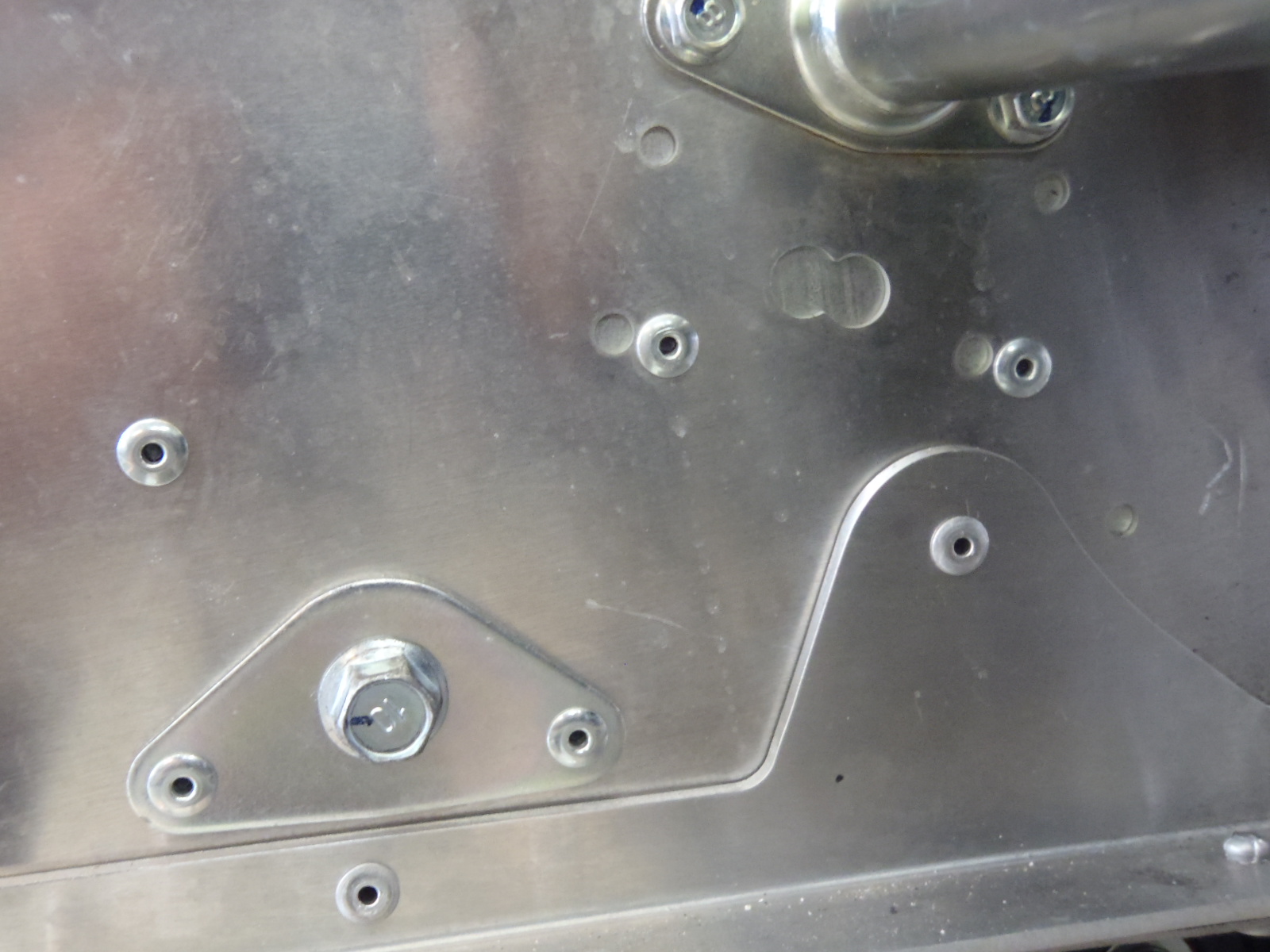

The last measurement is questionable to it's accuracy as my track is in, I just measured through track window. It will get you close. On my tunnel it has two holes factory cut for what looks like mounting holes for an XTX skid and RTX skid. I am assuming they do this as all the tunnels are now all the same?? I will try to post a pic tomorrow for you.
