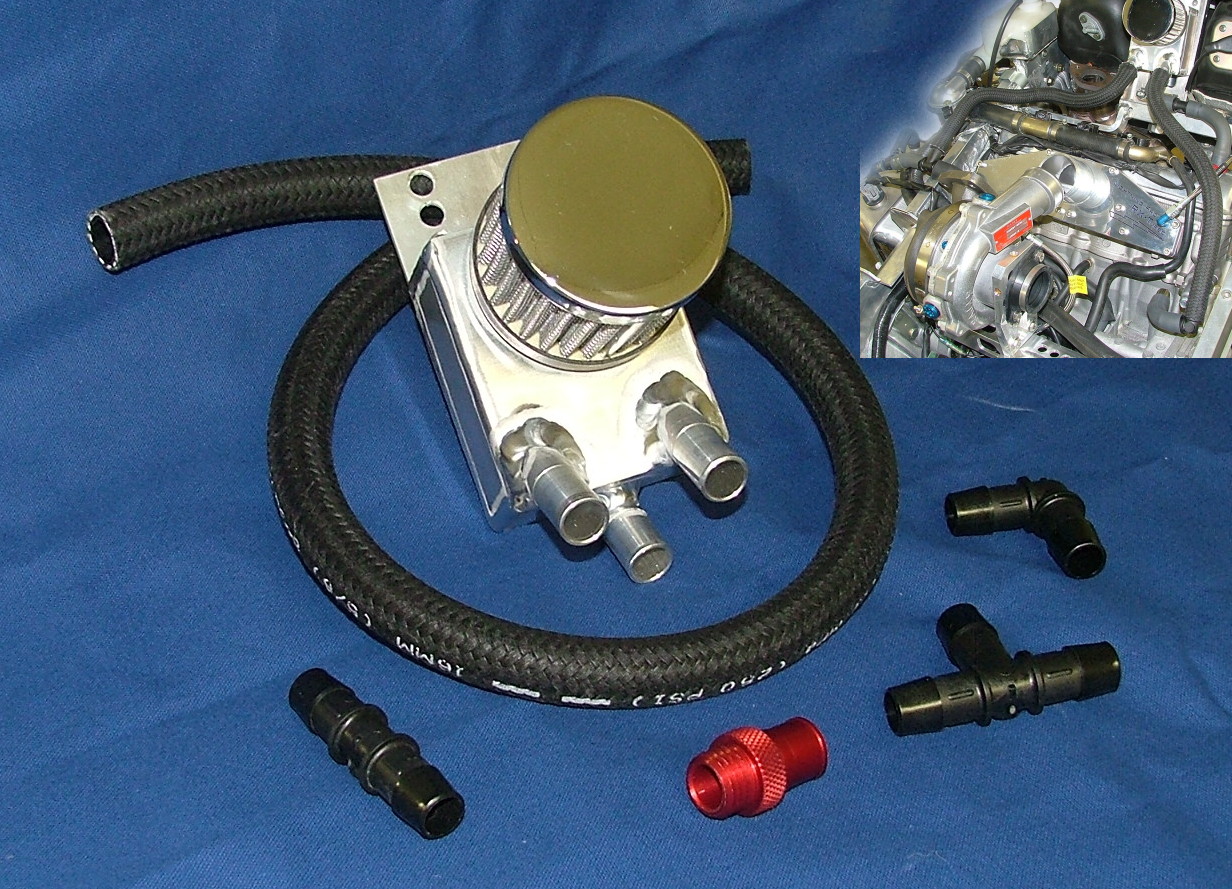

hey guys i was wanting to reroute my oil return to the valve cover and need to find out what kind of fitting this is? it has to have very course threads to work properly. it is the one that replaces the plastic oil cap on the top of the valve cover. thanks in advance!
i got this pics off here and i can't remeber whos sled it is.

If you cannot find what you need, I will sell you a fitting you can use. It is part of our Lightning Pro Evac kit and acts as a vent/drain fitting.
Let me know if I can help.

yes that look like it would have the right threads on it! if i don't hear from some one that knows anything about ht e fitting in the pic i will call you and buy the fitting you have1!!

It is not very difficult to remove the side cover. It can be done with minimal mess and effort.
We originally drained our turbo in the side cover also like Ted, but were concerned what could happen if a belt blew, so we drain in a slightly different location and use the valve cover location as a vent primarily and a drain for the evac box secondly.

It's not so much that I am worried, it is just the old "Murphy's Law" saying that if it can happen it will happen. When we were designing our kit it was more a matter of can we put this in a better spot and eliminate potential problems, and for our Lightning Pro Turbo Kit we utilized a boss area on the crankcase housing. It actually drains into the same area that Teds does and as Ted is doing allows for a very large drain hose from the turbo. Turbos that don't drain well burn oil. The same goes for venting, if the engine crankcase can't breathe it will push oil, that is why we vent in 3 locations. It might be a little overkill but it seems to work very well.

Hot Rod Rooster, Where exactly are you draining your turbo? Is is on that flat boss area next to the side cover and stock crankcase vent or further down. If you already have a good turbo drain location use the valve cover port as a vent.
