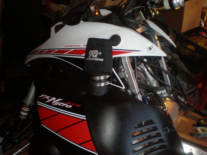

347strokin you may want to reconsider moving your intake location for two reasons, you'll get much better and consistent performance out from under the hood (personal experience taught me) and I think you would have an issue with belt dust plugging the filter in its current location. If it were mounted out from under the hood the filter will last almost indefinitely.
347strokin
woodsrider said:347strokin you may want to reconsider moving your intake location for two reasons, you'll get much better and consistent performance out from under the hood (personal experience taught me) and I think you would have an issue with belt dust plugging the filter in its current location. If it were mounted out from under the hood the filter will last almost indefinitely.
Lol, that's funny. I've actually made the situation worse to accomodate more meth/H20 capacity.
I shortened up the air intake and I am now going to have one meth tank above the belt guard that connects to a second tank in the nose cone.
I don't want to have to worry about my meth/H20 levels before my Trail Tank is empty from hard riding.
I've never worked with intake tubing before but let me know any suggestions about where I can plumb it alternatively. Thanks.

here are some pic's that might give you an idea as to what you can do. Formed Radiator hose for trucks works pretty well to get yoiu through the hood and is flexible and adds shock absorbtion. Just cut bends that you want out the piece. Relatively inexpensive also.
347strokin
That looks fairly simple. I'll have to check out some rad hose.

There you go,
Nice job, your sled will love you for it
I never did have to change my filter or my prefilter in the 3-yrs I had my Vector.
OBTW, are you using the silicon impregnated prefilter? If not you need to get one it will repell moisture where as the std prefilter will let it pass through.
347strokin
It says K&N Snowcharger on it so I'm thinking it might be the one?
Thanks.
