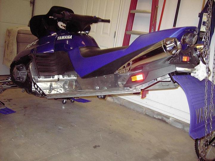

Yep, a new ripsaw fully clipped and the (dare I say this) Skidoo extrovert drivers. I cant stop it from ratcheting since I got it back from Freddie. I had it so tight that when I let off on the throttle it stopped like I hit the brakes. Then I mashed the throttle and it still ratchets a little, even with it this tight.............................................Cubby

That new lightweight transparent suspension would look good under there...if we could just see it.

I have Skidoo extroverts under mine and it still ratchets! Good luck! I can't figure it out. Unless I have track super tight it ratchets on take off and when climbing mountains. I have 1 5/16" of sag now and that's too loose so I'll tighten it to 1" of sag (between the upper side of the track and the bottom of the slider) to see if this helps. If not, I'll slowly tighten my rear suspension springs.
Honestly, I think it's the transfer rod elimination kit from MPI that eliminates suspension coupling and with my 2 1/4" finger track transfers too much on take off. I'll get the problem licked sometime.

SUPERTUNER said:That new lightweight transparent suspension would look good under there...if we could just see it.
Hee hee hee. Freddie, As a friend I am telling you this. Give up comedy and stick to making horsepower, Please!!!!!!!!!!...................Cubby
