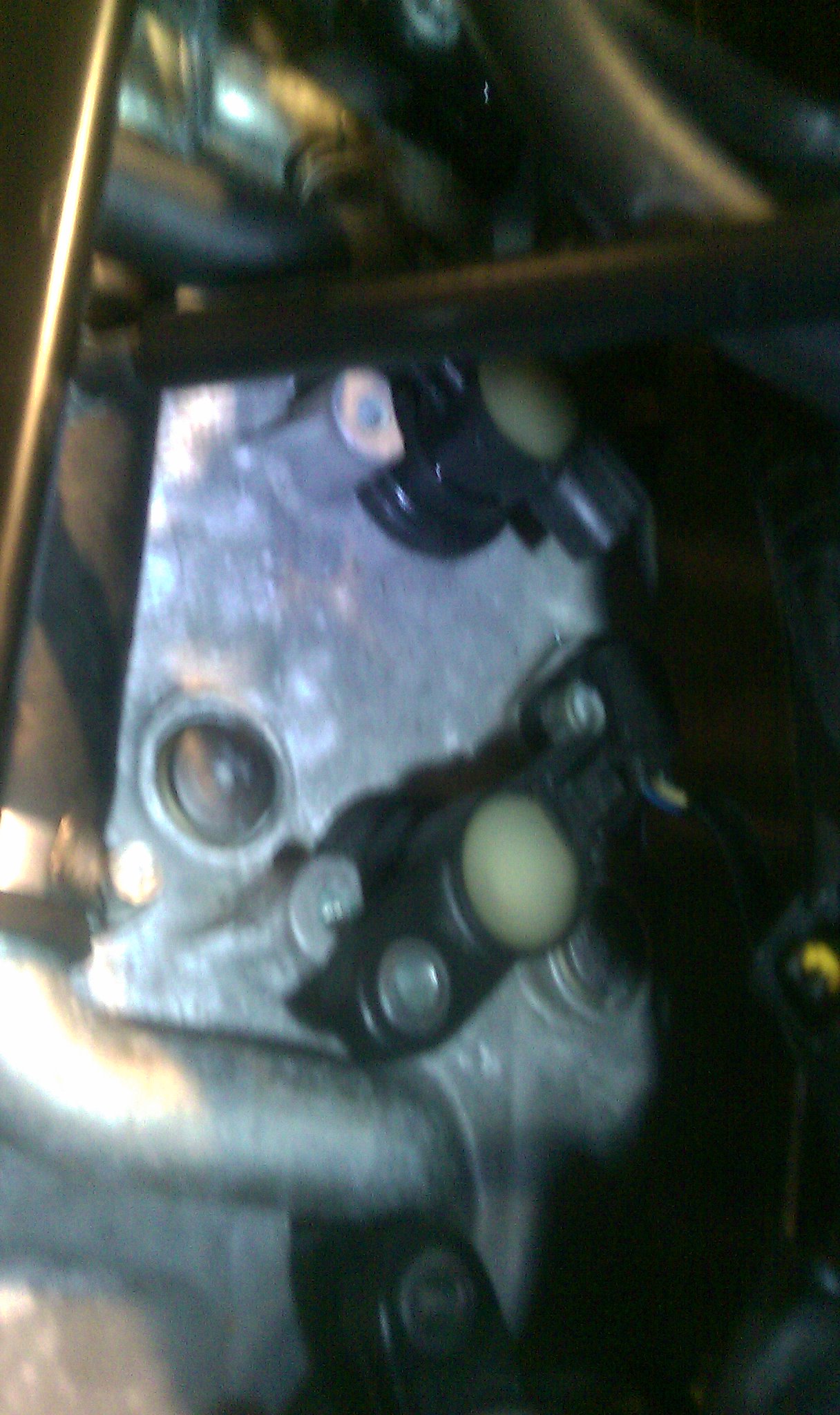

Ok guys, I'm not very mechanical but I've been trying to learn. I've done a lot of other things to my sled, but the simple one is getting me stuck and not riding yet this year.
Last year when I bought my sled from another person, I had the shop tune it up. So I never changed the plugs myself. So I removed the bolt on each of the plug covers. However, when I try and lift up on the plug covers, they don't budge. I called up a dealer yesterday and they told me to get some spray silicone and spray it in there and twist back and forth to loosen up. This hasn't helped either. I asked him if I should put a small screwdriver in there to pry them off and he said not to as I could short something out. Should I take a large adjustable pliers and pull it off or what would you guys recommend? Would really like to get out today...

It might be the wrong way to do it but I've always use the pry, ever so gently, method.
the kitchen
These must come out at the same angle they are facing. You may use a pry bar but use it gently and again presure must be at the same angle.
LJ 452
Twist and pull....can I say that?
It's not easy to get them out, keep trying and it will eventually pop out and you'll scar up your hand, and say a few choice words.

I've found the harder you pull on them, the more difficult to remove. Try twisting and pulling (very) gently and should come off.

put some gloves on and twist. have a long socket extension ready, the plugs are deep once you get the cap off
