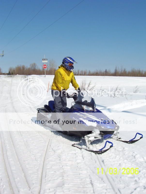

Once you start moding these sleds it doesn't stop.
Stock
Not stock
Since that photo Works shocks up front. Sway bar removed. Will be doing an undertunnel exhaust in a couple of weeks. And currently looking for a 159 track to put in it.
