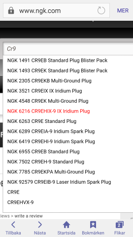

Can't see any Platinium in the NGK CR9 list? Only Iridium. Bosch?
Would think iridium would be better than platinum. Same design better material?Can't see any Platinium in the NGK CR9 list? Only Iridium. Bosch?

After reading on NGK website its the CR9EIX if you will test iridium spark plugs. Maybe CR9EIA-9 for guys running turbo with head shims? CR9EIA-9 projects slightly deeper into the combustion chamber.
CR9EIX
CR9EIA-9
CR9EIX
CR9EIA-9
