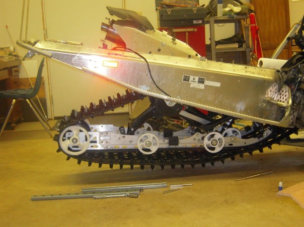

stretched my nytro se to 136 with tracks usa extensions. I liked it, I didn't notice any negatives to stretching it, other than it wouldn't fit in my damn short trailer. But it was way more fun off trail. The tracks usa tunnel extension is the nicest looking tunnel extension I've seen, It goes inside the stock tunnel and honest to god it looks factory, no gaps and its very strong.

Yeah those wheels look pretty sweet, but dont put them on the inside of the suspension, I think they take too many hard hits and won't hold up.
I got almost 2500 miles on those extensions, they are tough, not necessary to weld them together...but I did put a couple extra bolts through them.
The shock package is nice, but as stiff as it seems at first, it sure bottoms easy. The shock valving is all messed up...its really stiff and rough for small bumps but it blows through the travel quite easily in the big stuff. A shock revalve is definitely needed to make it work right in my opinion.
